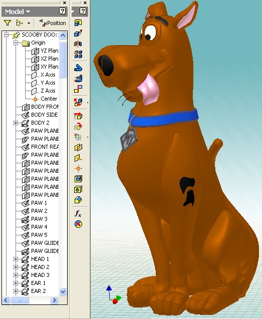

    I don't know if I can find the time to do this thing right - hopefully someone else will jump in here, but in general
    you should (almost) never be using Delete Face or Extend Surface unless doing something complicated
