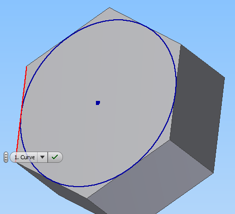

    Start a new sketch on one of the faces and Project Geometry one of the hex edges.
    Sketch a circle tangent to the edge.
    Sketch2.pnge

    Extude the circle Through All with the Intersect option and click the More tab and set to 45° to add a turned chamfer to the corners.
    Repeat on other side.

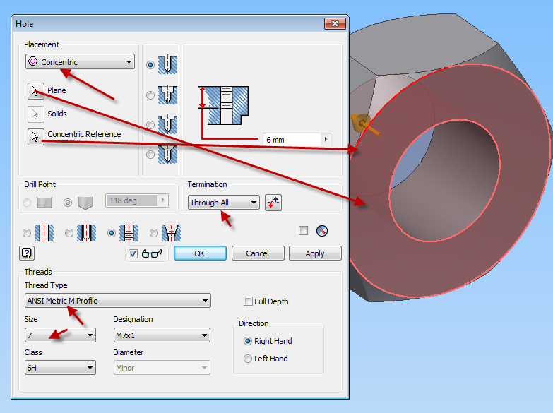

    Start the Hole command and set to Concentric.
    Click the plane and the circle and set to tapped and size.

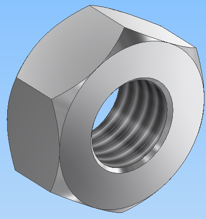

    Add a .25mm chamfer to both sided of the hole.
    Change to Chrome texture.
    Now isn't that just prettier.  Should make you feel proud!

    In addition to JD's comments
    M7 is NOT a preferred standard metric thread
    So it's either M6 tapping hole of 5mm Clearance hole of 6.6mm actual 7mm nerest drill OR M8 tapping  hole of 6.8mm 7mm nearest Clearancehole of  9mm actuall
    NOTE
    These are UK nearest Tapping hole size they may vary slightly according to different country's standards & drill sizes available.
