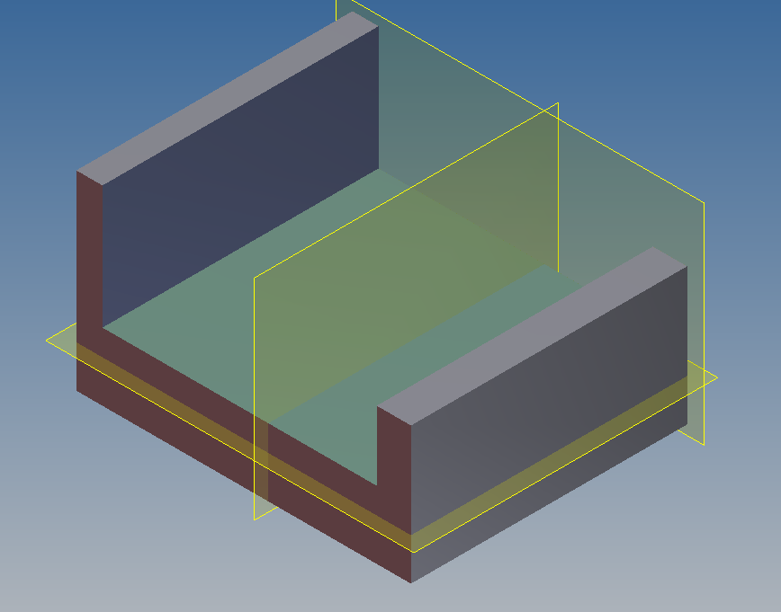

    Use the copy object command, select the face and either composite or surface command. Either will let you color them seperately just by selecting in the browser and applying color to the surface you create. Note: The colors will not appear as bright as you are used to seeing them (In my example Green (flat) Red (flat) and Blue (flat)). You must also create each surface seperately if you want to color them different colors, otherwise you can select multiple faces.Copy Object.PNG
