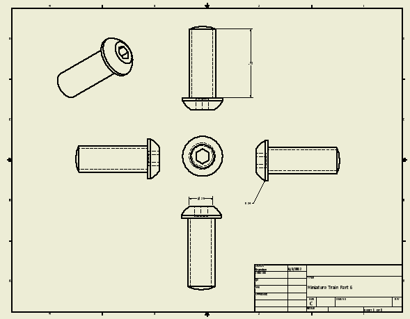

    Really quick question,
    I am doing a drawing on inventor and everything is going great except for the fact that the dimensions are hard to read because they are so small. Is there any way to make the font for the dimensions bigger.
    Thank You

    Sure.. Edit the dimension style or create a new one.

    ...but something doesn't look right.  You dimesion text should not be that small.
    What size sheet is that.  Has anyone fooled with your dimension styles?

    You're drawing a 3/4" screw on a C size sheet...
    If you use a normal sheet size, I would use A or 8.5x11 for that, it will look closer to what you would expect.
    But I have to ask, why are you making a 6 view drawing of a screw?

    Looks like a "C" size sheet.. So I'd expect the text to be that small.
    You REALLY need to get familiar with how the style/standard editor in Inventor works.. Its VERY important that you set it up for your needs now..It should be covered in day 1 of training IMO even before you start modeling parts.
    Its always best (in my opinion) to edit styles/standards through your template files.
    So open your drawing template file and go to the style/standard editor..Find the default dimension style and change the text size. Then save to style library (your project file needs to have use style library to read-write (assuming you are the cad manager or only user and should have rights to modify that stuff of course)

    You could change the size of the Text Style used in the Dimension Style, but I think the issue is really that you're using a C sized sheet  (17in x22in) to detail this small part. That is a very large sheet of paper, and isn't typical for the type of part you're working with.
    This looks like a school project, so I think getting into style editing is a bit more involved that what you're really after here.
    Try this first:
    • In the browser right-click on the Sheet node (likely Sheet:1) and choose Edit Sheet.
    • Set the Size drop down to use size A (8.5 in X 11in.)
    Your title block will now be too large.
    • So, go to the browser again and locate the Titleblock node under the Sheet node.
    • Right-click it and choose Delete.
    You've deleted the instance of the title block, but the definition still resides in the drawing under the Drawing Resources folder.
    • So, go to the browser once again and locate the Drawing Resources folder node and expand it.
    • Expand the Titleblock node and look for a titleblock definition called ANSI A
    • Right-click on it and choose Insert.
    You might need to edit your views now and scale them down to make things fit.
    If this doesn't help, post your drawing file and someone can have a look.
    I hope this helps.
    Curtis

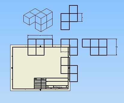

    Okay excellent it worked.
    But now, when i change the paper to A and the title block back to normal, the drawings i had are know bigger than the page. How can i scale it back to normal so i dont have to delete it and redo the sketches because I made a lot of drawings and it would take to much time to redo them.
    Thank You

    Right-click on your Base View (be sure you're in the view and not on an object line, etc.) and choose Edit View, then set the Scale to a size that fits (you can experiment with different values 1 or 0.5 or 0.25, etc).
    Most of the other views are likely taking their scale from the base view, so they should update also. You might have to drag them into place though. For any views that don't scale off of the base view (such as the isometric view), just set their scale the same way individually.
    I hope this helps.
    Curtis
