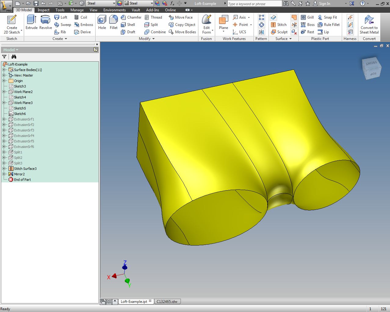

    Member
    Posts: 5
    Registered: ‎08-27-2012
    Re: Loft with multiple openings
    01-24-2013 06:32 AM in reply to: nick.jeuris.hotmail
    Thanks for the quick answers.
    I found a method which gives a satisfactory result.
    First I made 2 lofts, next I deleted the faces in between the lofts and finally, I patched the 2 lofts together.
    I have attached a screenshot of the result.
    Thanks everyone for the replies!

    Valued Mentor
    mpatchus
    Posts: 258
    Registered: ‎10-22-2008
    01-24-2013 07:35 AM in reply to: nick.jeuris.hotmail
    If you want this to be a true sheet metal transition which could be flattened, you would have to make two halves like the attached.
