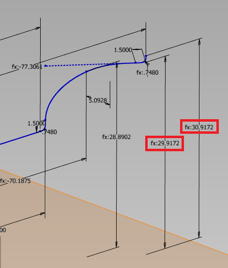

    When this happens to me, I try to find a way to dimension both ends of the line segment from an origin (or work) plane.  This makes sure that the line doesn't flip directions.  For example, the image below shows one such segment.  The two indicated dimensions are for each end of a line segment (that has a bend applied to it).  In this case, the dimension on the left is just the parameter of the dimension on the right, minus 1.
    This example is from the attached part, 3D Sketch6.
