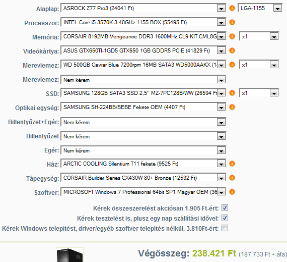

    I do some rendering but none of the rest. Thank you for enlighting me about Inventor using DirectX. I've ended up the config below (there's some hungarian text, but you can ignore them). It is about $890+VAT (27%).

    how long are you planning on using the pc for?  only ask because that PSU is 430W and I dont think it can handle a graphics card more powerful than a GTX650.  So... If you wanted to upgrade the gpu in a year or 2 then you would also need a new PSU, so why not plan ahead?
    Speaking of the GTX650 - it's not an amazingly good graphics card, just see how far down the benchmark it is:
    http://www.videocardbenchmark.net/high_end_gpus.html
    Personally, if I was to build a pc today, I would go for a GTX670 (660ti or 570 if you can't afford a 670) - plus a 600-700W psu to give me plenty of headroom for upgrading in future.  I know the GTX670 is a lot more than the GTX650 but hopefully you can find a GTX570 for only a little bit more and it is a lot more powerful.

    Based on our company's tendency, for 5 years, at least. 430W is more than enough for a 670 GTX, too. 500W+ PSU needed only for CF / SLI configurations. This whole config won't exceed 300W from the outlet, I bet.
    I have a i5-2500K / GTX 560 Ti / SSD / 3 HDD config at home with a Corsair VX450W PSU. I've never measured its power consumption... yet. But now I'm curious.
