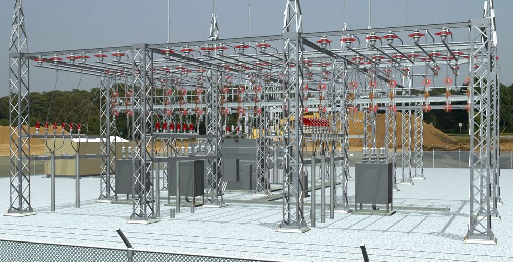

    We create all of our structures in Inventor.
    Bolt holes now line up in the field and everything goes together much more quickly and easily.
