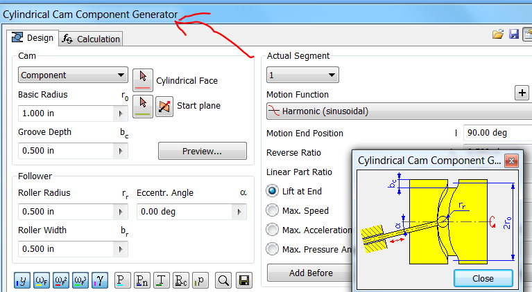

    Is there any reason you can't use the Cylindrical Cam Generator within Inventor?
    Also,
    I noticed that your first sketch and several others were not constrained.
    It is pretty automatic to constrain a circle to the origin and I would pattern the slot feature rather than the slot sketch.
    This might be if interest,  I (or someone) will demonstrate the Cam Generator if you can't figure it out.
    http://home.pct.edu/~jmather/SkillsUSA%20University.pdf
