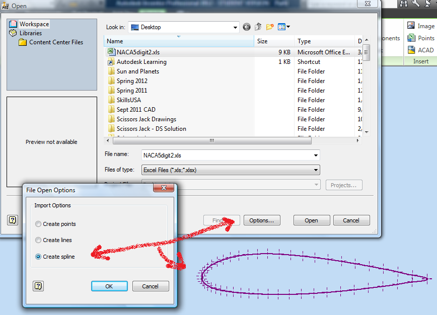

    I verified that the xls works fine on my machine - so now we need to figure out what is different on your machine.

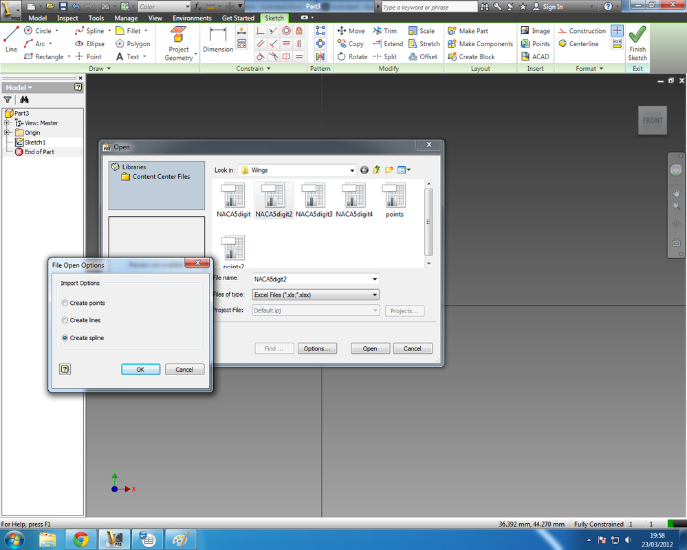

    Thats the same screen that I have, minus the drawing.
    I have the free version for students but I dont think that should make a difference. Is there anything you need to do to prepare the sketch before you start importing points?
    I have followed this tutorial to the letter, but it doesn't solve my problem. http://usa.autodesk.com/adsk/servlet/ps/dl/item?siteID=123112&id=8324557&linkID=9242018
    The most annoying thing is that the window to choose the file just closes when I press 'open' and no error message appears.

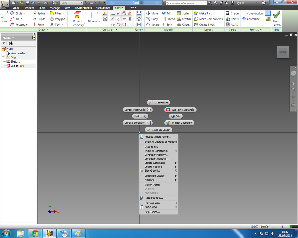

    before
    after
    I've just noticed that it has the option to 'Repeat Import Points', but when I undo, It closes the part like it would normally with a part that had nothing in it.
