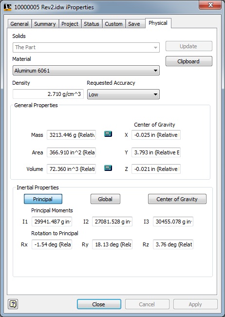

    Due to the nature of the parts I cannot post them here. I dont know if it will help but I posted a combined screen shot to show the different aspects of my 'weight' calculator (which works awesome other then this instance!)

    If you go to the Tools tab > Document Settings button > Units tab is the Mass setting set to lbmass?
    From that last screen shot it looks like it's set at grams.
    To avoid this kind of confusion you might update your iLogic code to check the Units of Measure so that it does not add a suffix of lbs when that is not the current unit of mass. Or at least informs you about it.

    Thanks for that link and snipit of code. Worked perfect! Down to 7.1lbs.
