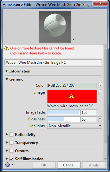

    Just curious... could this have something to do with it?
    I can browse to the file but why wouldn't this have come over automatically? Should I just go copy all of our surface pictures over to the surfaces folder in 2013?

    Okay so after copying the bitmap files over to the surfaces folder in IV2013 it seems to have worked. I haven't tested every one of our appearances yet but the two I tried worked fine.
    I'm not sure why these files wouldn't get copied over as part of the migration process though. It certainly wasn't mentioned in the documentation anywhere.
