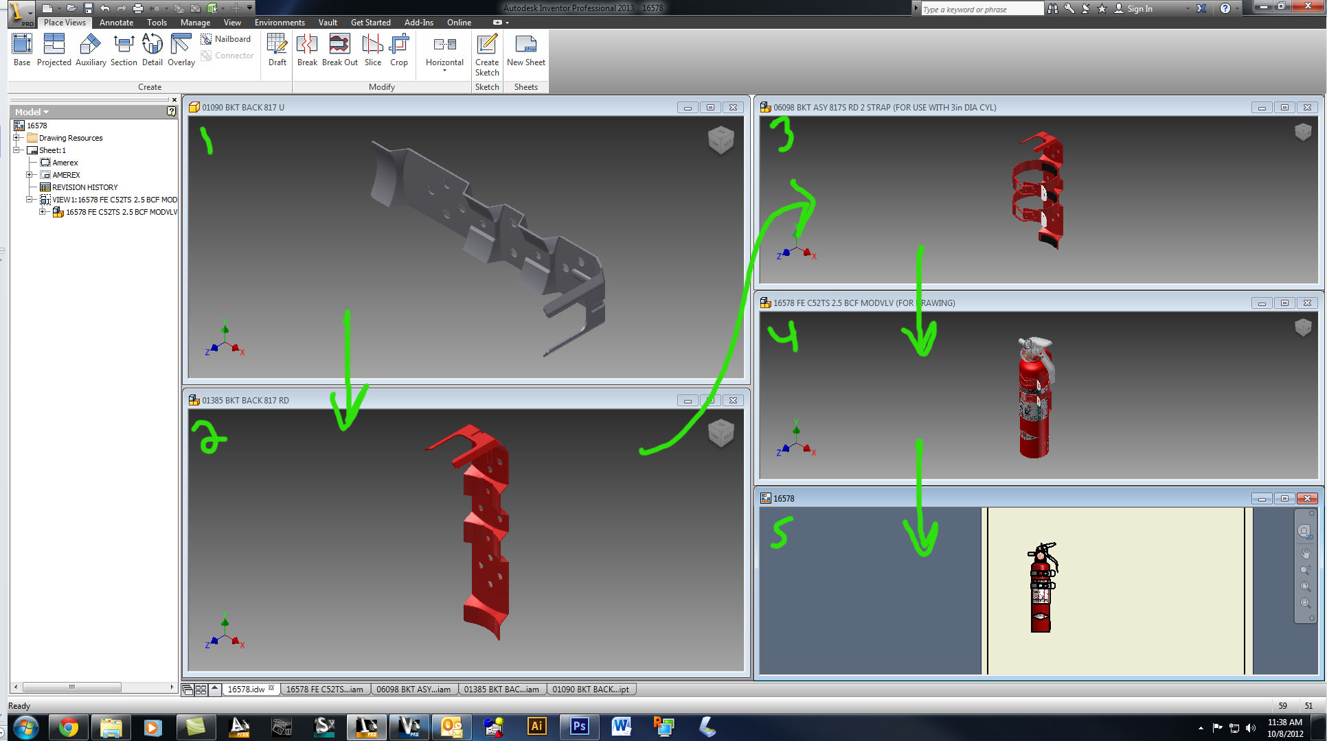

    So any ADSK solution (hotfix) to this? It is beginning to become a sore spot within our engineering groups. We are on Inventor 'Update 2' and still having this issue.
    Please see screenshot below for further explanation...
    As you can see on my top level view that the bracket assembly does not show the correct color style and is reverting to a raw material it seems. However if I open the same exact bracket assembly model from within my top level assembly and place that bracket assembly as a new view the color style reflects as it should. In this case a red painted bracket assembly.
    This was an issue in previous versions of Inventor sometimes. The 'trick' used to be to toggle the Representation from Default to Master and back to Default to 'fix' the issue. This worked 99% of the time. However since 2013 Inventor and the new styles/material library this seems to no longer work.

    This screen shot might help illustrate the issue I'm seeing....
    If I try and replicate this behavior from scratch in 2013 I'm unsuccessful and every step works as it should.
    • I created a simple circle using steel raw material and steel default color.
    • Next file is an assembly where the steel circle is 'painted' red.
    • Next file that red painted circle is used in an assembly with other red painted components.
    • That sub asy is then used in a top level assembly with a slew of other components and sub asy's.
    • Final drawing (IDW) shows the correct color style and doesn't revert back to raw material (as it shouldn't).

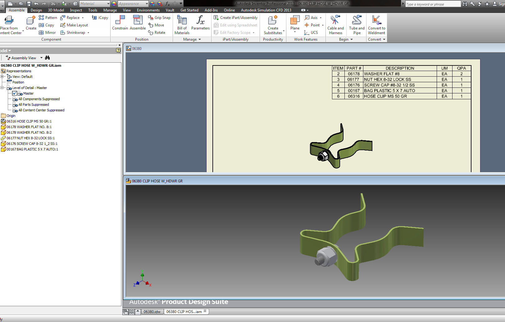

    Well SP1.1 did not fix this problem. If anything it seems worse now.
    Haven't heard anything back from ADSK either...

    OK I think I found another temporary 'fix'.
    If I create a new LoD but don't make any changes, that seems to somehow force the IDW to fix itself. Don't ask me why or how but it does seem to fix this issue. It seems Inventor is getting confused which correct appearance or view rep to show for the drawing when you get a few levels up from a 'painted' IAM file. Seems to happen around the first sub-asy level or sometimes top level. Strange behavior but I hope they get this fixed in the next release. It's been an issue since 2011 IIRC but not near as bad as 2013.
    Below is a scren shot after I created a new LOD in the assembly. This fixed my drawing. I then went back to my assembly and deleted the 'new' LoD. Drawing still showing the correct appearance so perhaps this is a fix. Crossing fingers LOL.

    Never mind about the LoD fixing the issue. It's back again. This behavior is very strange and I can't place my finger on what exactly is triggering the issue. Some help or anyone else experience this??
