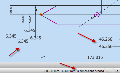

    First thing I notice is that your sketch is not fully constrained.
    Second thing I notice is you have a bunch of repeated dimensions that are not needed. (see attached)Repeated Dimensions.png
    Let's start this thing over again from scratch.
    Sketch a single line horizontally from the origin over to the right and dimension it 173.015
    Attach the file here.

    Re: I need help.
    01-10-2013 09:01 AM in reply to: EScales
    EScales wrote:
    I noticed the same thing, but didn't want to get into teaching a basic Inventor class.
    First post by OP - we should get them doing the basic stuff right before they develop bad habits.
