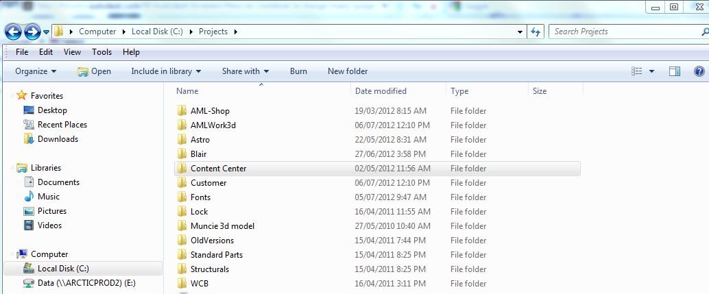

    We keep all our standard product under a single project. Any custom work we do under a Custom project which has our standard product as a read only library. This allows us to pull in any stock product and prevents us from accidentally modifying it for a custom unit.
    Our standard product directory contains over 10,000 different files. Any CC parts that we stock in our ERP system, are saved as "Custom" into our standard product directory.
    Our Standard Product directory and our Custom directory are at the same level and not nested one inside of the other. This allows us to set the other as a read only library allowing for use of existing parts, but not being able to change them unless you are in that project.
    Others may have better setups that suit their needs as well. The "AMLWork3d" is our standard parts and the "Customer" is for custom outside work. The "AML-Shop" is for all  our jig's and fixtures. They are all at the same level with other required directories as Libraries.

    Hi Blair, I would like to thank you for your post, it helped.
    I'm reading the book Mastering Autodesk Inventor 2012 from Curtis Waguespack, I think i misunderstood it when it cames to content center. We are desingning machines with different components (there are hoods, retraction systems, heat exchangers, combustion chambers, etc...) that are all parts of the same contract (for one mill). The way  i started is to define a content center for each components and each component is a project (one CC/Project for hood, one for combustion chamber, etc...). Now i think that i should only have one content center including all the contracts?(so one content center at all on the server?) and one project for each contract/mill? So when it comes to reusing parts of a project into another one ill just have to copy the assembly i need into the new project folder? To make short, an Inventor Project should include everything from a single job and a single job should have only one project related to it?
    Thx for your time, KL

    You could have a project for each assembly. Myself, if it's for a single end user, would be to have a single project to encompass the whole job along with a single CC. You may just wish to have  your individual parts either numbered incrementally or have a primary part number for each major assembly (XXX1-0000) and then have the parts for each major assembly with all parts for the assemblies as XXX1-0001 and XXXX-0002 in numberic sequence.
    When it comes to part numbers, it's up to the end user to decide.
