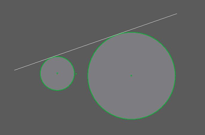

    I have 2 different diameter cylinders and I would like to create a plane that is tangent to both.

    Probably more than one right way... but what I did was to create a sketch on the face of one of the cylinders, project geometry both cylinder OD's.  Then sketch a construction line tangent to both cylinders.  Finish Sketch.  Now create a plane by selecting the sketched construction line.  As below:
    Like I said, there may be a better way to do this, but this seemed to work and was fairly easy.
