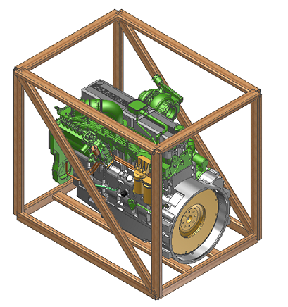

    There are many ways to do this kind of thing, but you'll want to think about what the end goal is (re-using parts, obtaining a parts list, etc.)
    Here's one method that I would recommend you explore using the Frame Generator:

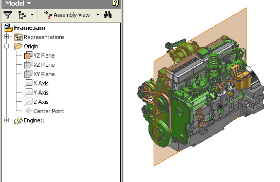

    • Start a new assembly and then place the model the model that you intended to design your package around.
    • Then locate the origin plane on which you will create a new part/sketch (this will be a new file).
    • Once the new part file is created you can Project Geometry from the existing part into your new sketch:
    • Then you can create a rectangle and dimension it based on the existing model:
    • Then extrude the sketch to create a block. Here the new part is finished. It's just a clear rectangular block that defines the extents of the package:
    • Now you can use the Frame Generator to place frame members on the edges of the block:
    • Once the members are placed you can trim, miter, etc. as needed. Another benefit is the ability to change the base block and have the frame size update automatically.
    As others have mentioned this involves a lot of different tools in Inventor and so some understanding of how Inventor works will be needed first off. You'll also likely want to create a custom "lumber" frame generator library to use standard sizes, etc. so that you can output a parts list.

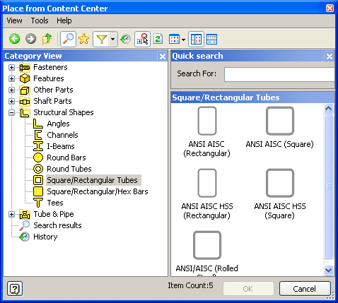

    I tried the frame generator and I really like how I can make specific libraries. I obviously need to get some training so I have a little more knowledge about this program, but I was wondering if there is a way that I can just insert something out of the library and type in a length and use it wherever I want as opposed to having to select a line first?
    Thanks for your help!

    Hi calhoung,
    You can use the Place from Content Center button to do this , assuming you have the Content Center libraries installed. You can do this two different ways:
    • On the ribbon, click Assemble tab Component panel Place from Content Center
    • In the graphic window of the assembly, right-click an empty area and select Place from Content Center from the menu.
    Once in there, you can select from the library categories:
    Upon placement of structural shapes you can specify the length:
