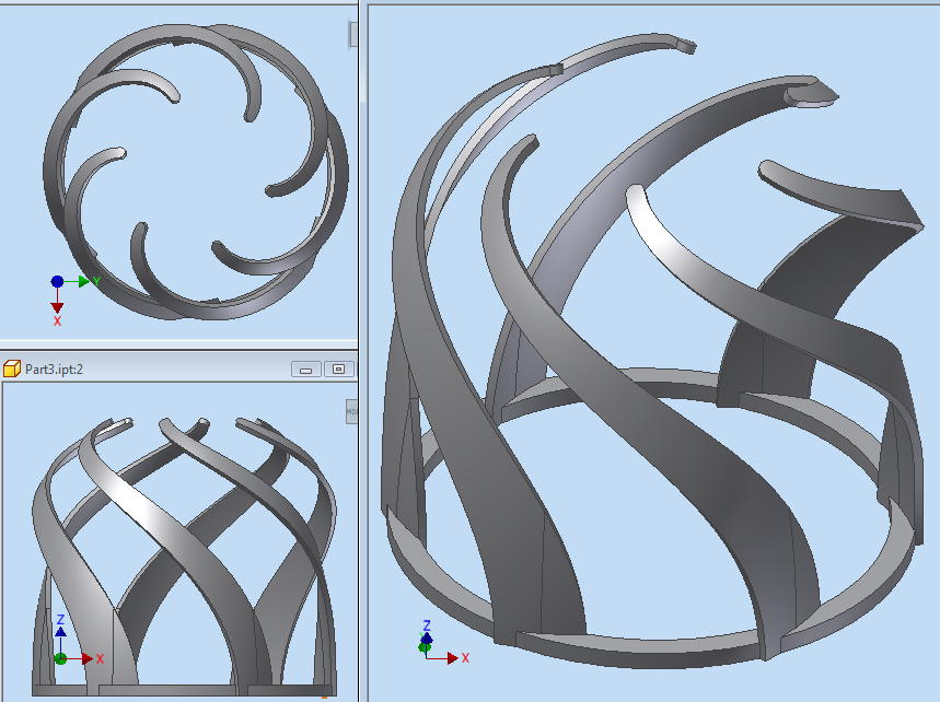

    I am trying to draw this cutterhead.  The 3D sketch and helical curve commands have a allowed me to create part of the "arms" with the teeth on them but I can't seem to get them to come up and over the hub in the middle.  Only to the top of it.  Any tips?  Thanks.

    Why did you use Driven rather than Driving dimensions in Sketch10?
    I would have used the edge of a Coil surface body rather than the 3D sketch - much easier to control.
    I would avoid adaptivity for this design.
    Sketch12 is not constrained.
    You might start with this document http://home.pct.edu/~jmather/skillsusa%20university.pdf
    I suspect I would Thicken a trimmed helical surface.

    Do you have a picture from side and top?  You have an assembly - do you have a 2D drawing from which it was made?

    Here is an alternate solution - more information would be needed to get precise representation.
