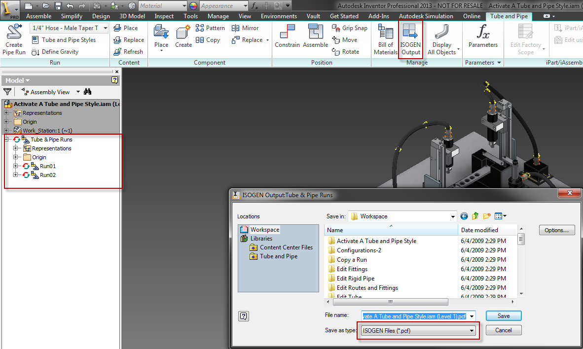

    Inventor will export a PCF file, but it will not create the piping isometric (not the same as what some drafters consider an isometric view).
    In Inventor you will have to use traditional drafting tools to get your isometric, there is no magic piping ISO button.

    Activate a Tube & Pipe Assembly and then use ISOGEN output.

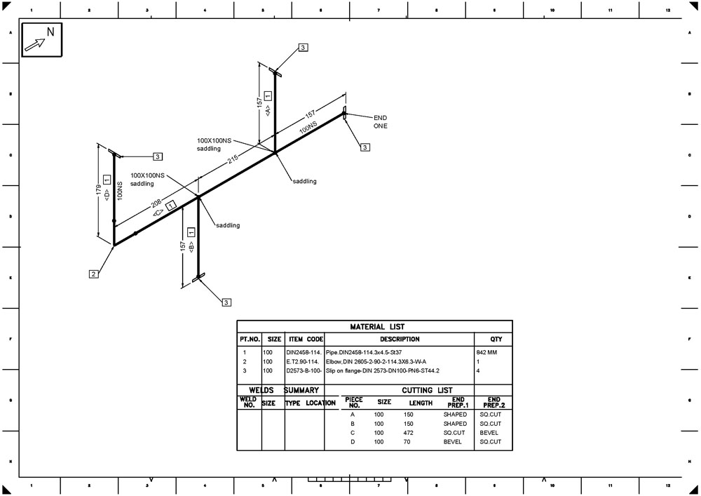

    i mean this kind of output for workshop use
    Please use plain text.

    If you tried the PCF output from Inventor and then put it through the Online WS converter and that was not enough for you then you are out of luck.  You will need to use a different program to complete the piping isometrics that you want or do some tedious work in Inventor.
