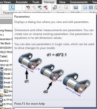

Did you look for the dimension here? This is where you can rename it to make it easier for locating it.
