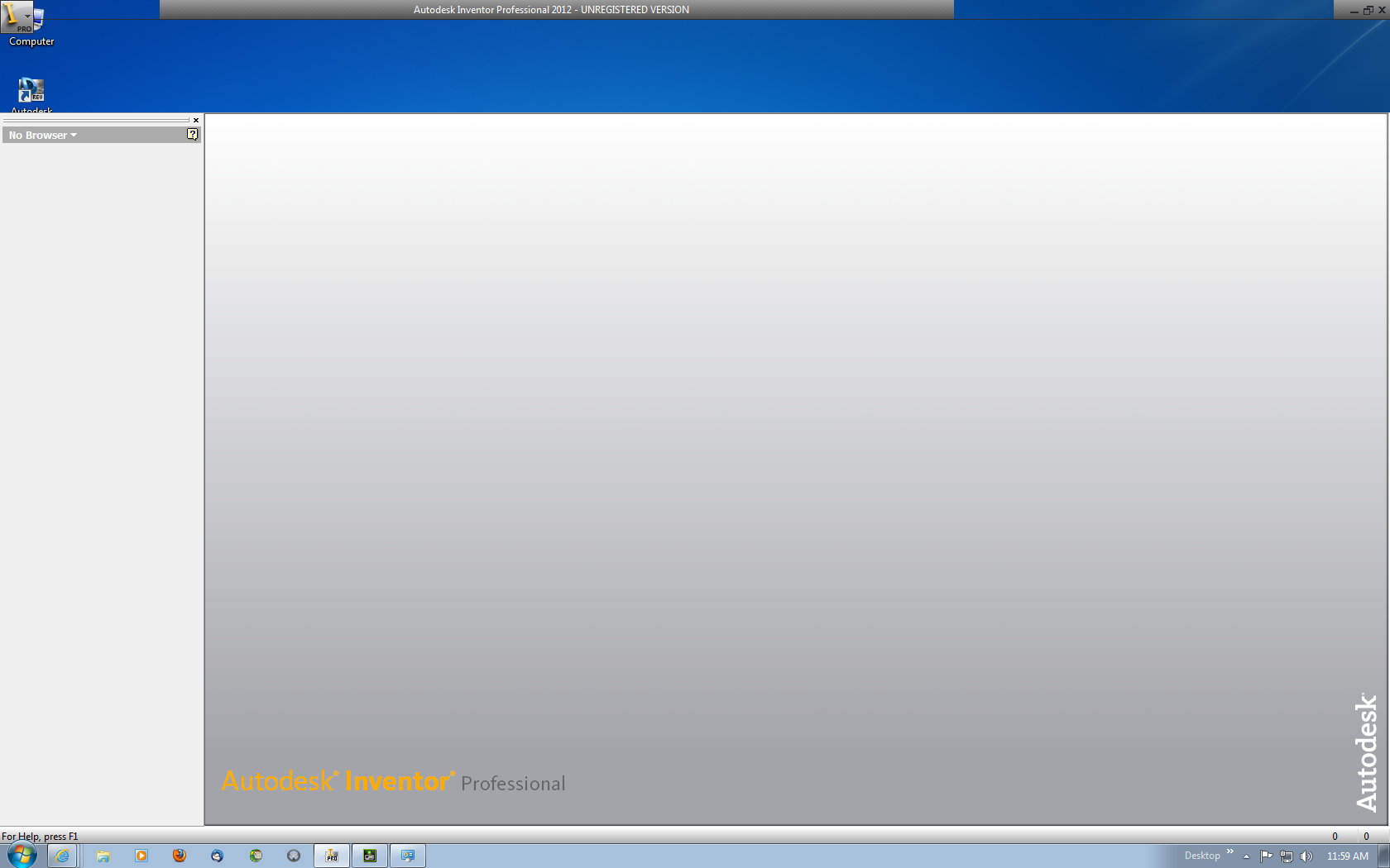

    Ok guys I have a little issue. Just built a new rig, see spec below:
    And installed Inventor 2012 on a vanallia install. Iinstalled the OS, Win 7 64bit, updated windows, instaled motherborad and video drviers, then installed inventor 2012, installed sp1 for inventor 2012 64bit
    The issue is the toolbar ribbon is missing on the graphics? See below
    Any ideas? Thanks

    This looks suspect:
    There is something wrong with your drivers / card / installation, unless you really only have some old version of DirectX...

    try installing the latest driver.

    No dice, see below. I already have direct X 11 installed.

    I have the latest Nvidia driver installed. :smileysad:

    The 2 screen dumps are showing different DirectX versions?

    To have a graphics performance like that, I suspect that you have a power supply problem with the above-board power supply to your graphics card. You should have at least one power supply cable going directly to your graphics card.
