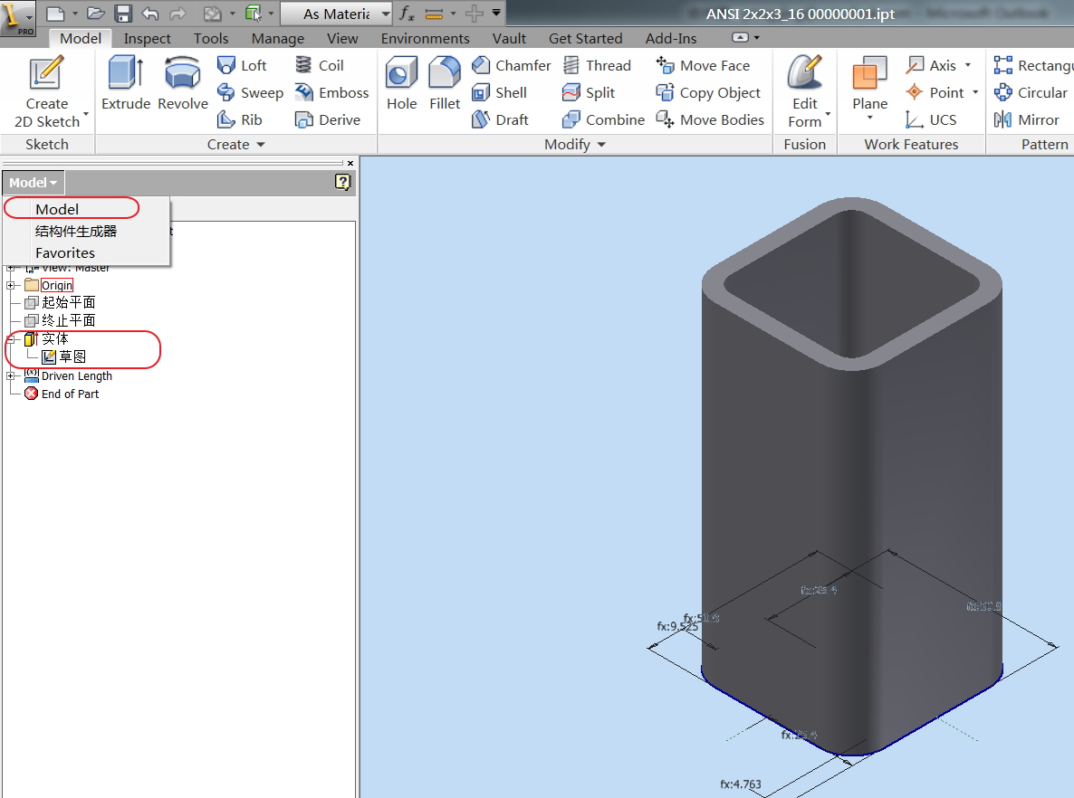

    Is there any way in standard inventor to find what sketch is related to a frame generator member?

    Not talking about that sketch.
    I'm after the sketch within the frame skeleton after the member gets assigned to a line on placement in an assembly.

    Open the Frame part, in the model browser, you could see the sketch in the browser's dot.

    Thanks. It's the driven sketch I'm after. As shown in your picture.
