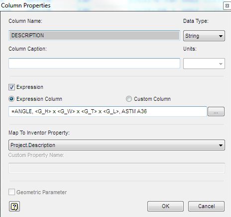

    Okay, this is actually a REALLY long and involved process to do, and it's going to require you to create your own custom CC libraries, and then you're going to need to do the save as template thing as well.  This process is NOT documented by Autodesk in any way, shape or form that I am aware of, and it took me a couple solid weeks of searching through blogs and the help files to get all the disparate pieces to come together and make it work the way that I wanted it to.
    First thing, do you know the difference between expressions used in an iPart table and expressions used in iProperties?  That's key.
    Once you've created your custom CC library - and for this I just copied all the structural shape libraries to new libraries under my company's name - you're going to need to edit the table for it.
    My company uses Project.Description for the part description.  Inventor defaults to use ... I think it's the family name in that field?  You'll need to create a new column, which in my case I entitled "description."  Right click on the column header and edit the column properties in a manner similar to what I've shown here:
    Note the format that I've got the expression in.  This is the format that iProperty expressions use.  The CC table will not recognize it as an expression, and will handle it as straight text.  When the part is generated, this text will be dropped into the iProperty Project.Description, where it will be recognized as an expression and evaluated as such.
    (Also, I should perhaps mention that this custom CC family is based on the ANSI L (Unequal Lengths) table, and other families may have somewhat different table contents and variables used.)
