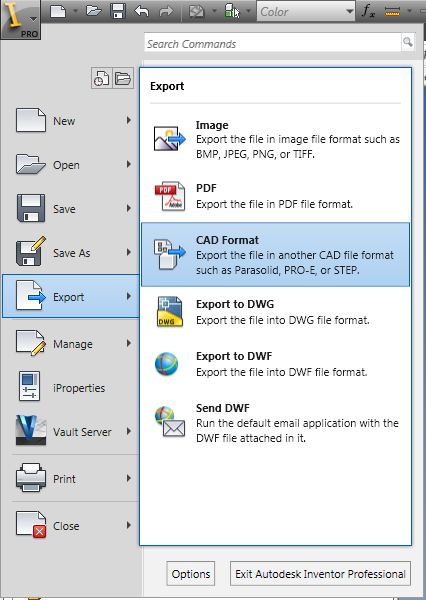

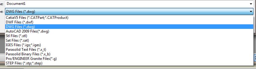

    Jan,
    These are the formats that Inventor can export out to.

    Thank you!  I see that DWG is one of the formats.  It looks like these are export options from Inventor Pro.  What if my client only has Inventor Light?  Are the export options limited there?

    I am not aware of an Inventor light.  There are different levels (i.e. standard and professional)
    and with all of those the export options are the same.  I know there is Autocad light.  There is also Inventor Fusion
    with these export options.

    if they provided you .iam files, then they have a full version of Inventor.
    Inventor LT doesn't do assemblies...
    And yes, it can do .igs (.iges) also

    The files can be saved to dwg, dxf or igs (and other types).

    You could do the conversion yourself with FREE Inventor Fusion http://labs.autodesk.com if they can't get the dwg to you, but you will need the ipt files that go with the iam file(s).
