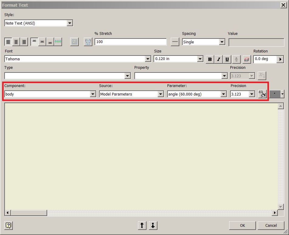

    What version? I'll assume 2013.
    In a text note or in the title block?
    If you need it in the titleblock you'll have to use an iLogic script to do this. (A very very simple one)
    If you need it in a text note you can reference parameters directly in the text editor.

    Dear Mike,
    Thank you for your reply. I am working with inventor 2012.
    This is exactly what I want, use the parameter into a text box. I do not know how to link the text parameter of an assembly or part with the ipt. Hope you can help me. With your solution you can not choose text paremeters.

    I belive linking text parameters in a drawing file is a new feature of 2013.
    Unless you want to upgrade, you'll have to use iLogic to filter through an iPoperty. Here's a snippet that will do so. You'll then simply insert the iProperty from the drawing into your text note.
    iProperties.Value("Custom", "PropertyName") = Parameter("yourPart.ipt.yourParameter")
