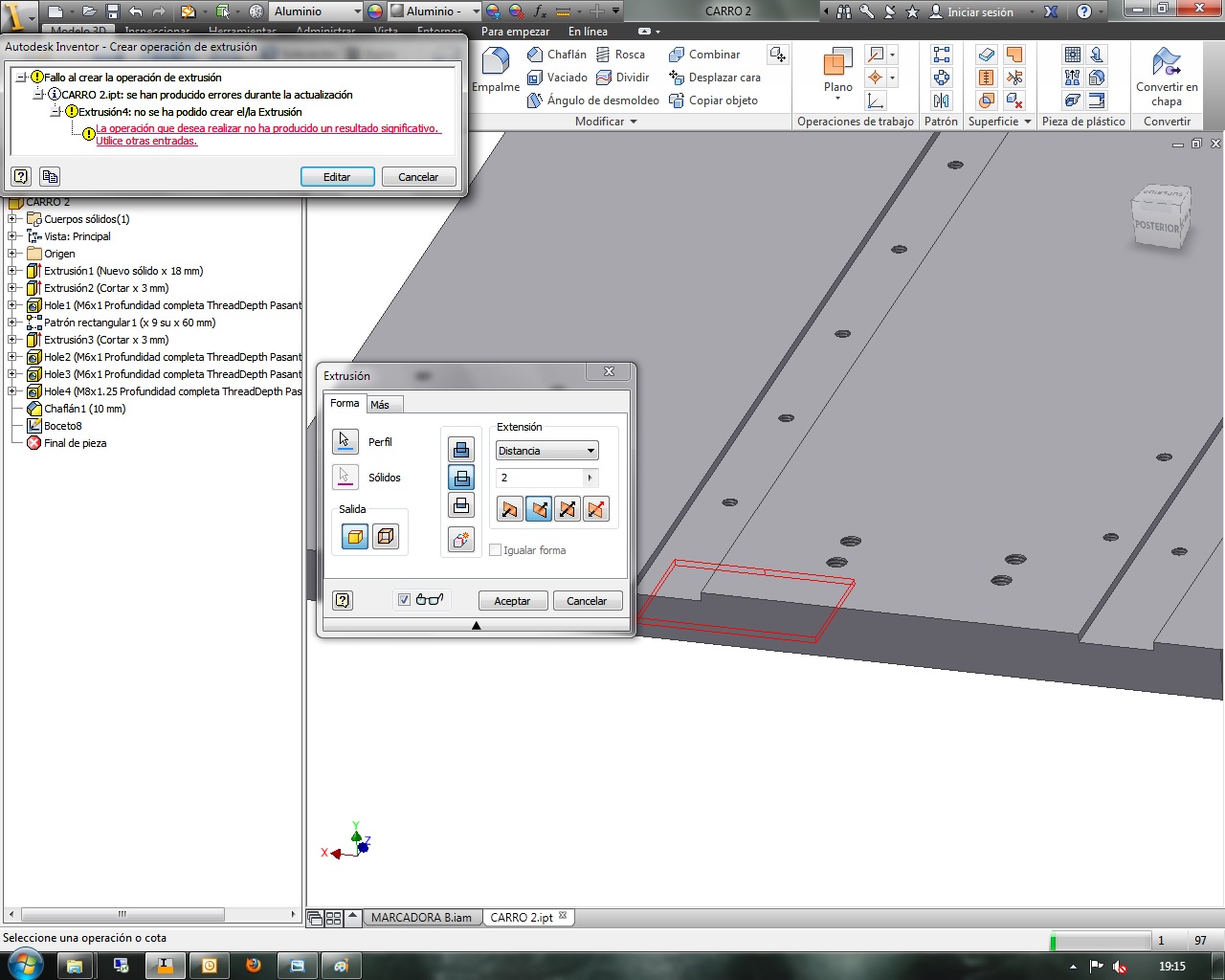

    Always same error: Operation doesn't produce a significant result. Redefine inputs
    If Inventor is totally closed and reopened, I can modify and update parts without problems for 10-30 minutes, until first error, then it gives errors until closing again. Usually, but not always, operation preview begins to fail before first error. So it's quite difficult to reproduce.

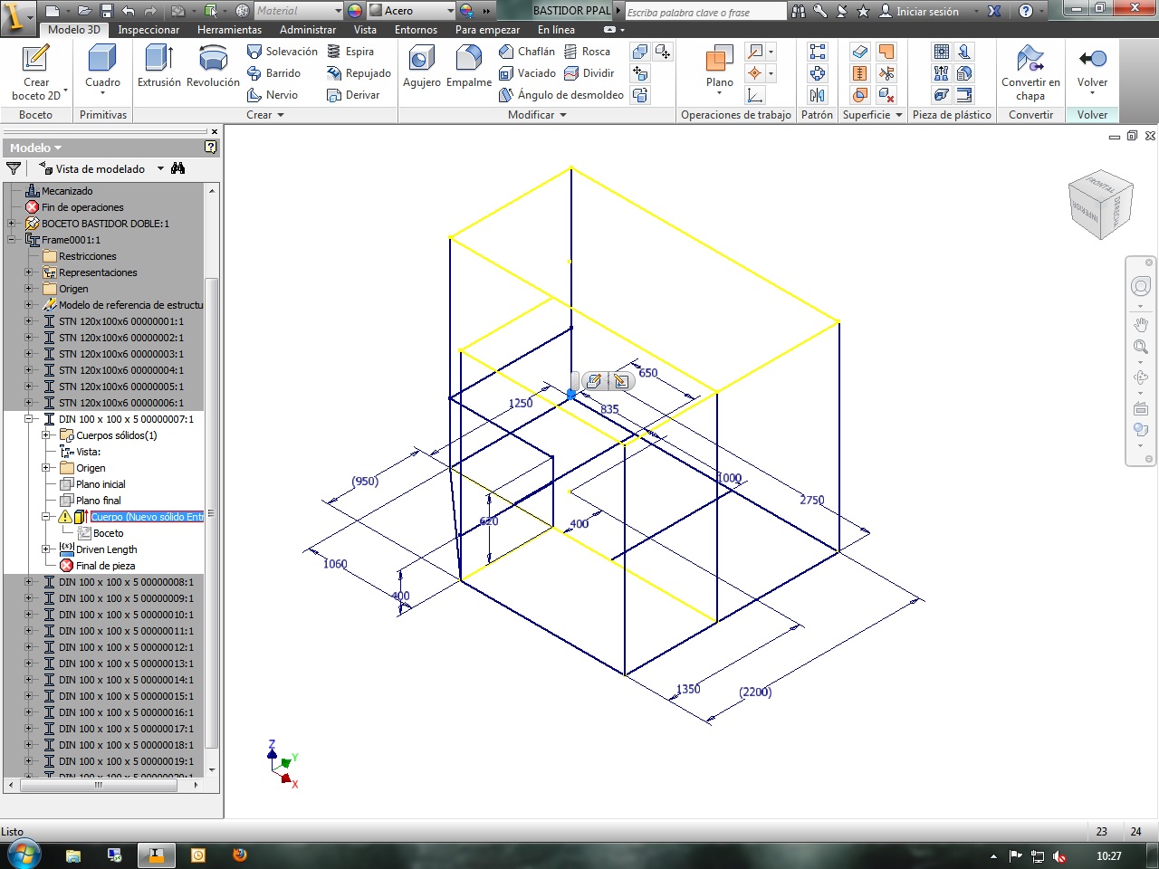

    Hi! Thanks for showing this issue! Unfortunately, I cannot seem to reproduce the behavior on my end. Based on the images you provided, it seems like the modeling operations (hole or extrude) fail for no apparent reasons. The true preview is not correctly shown which already indicates something is wrong.

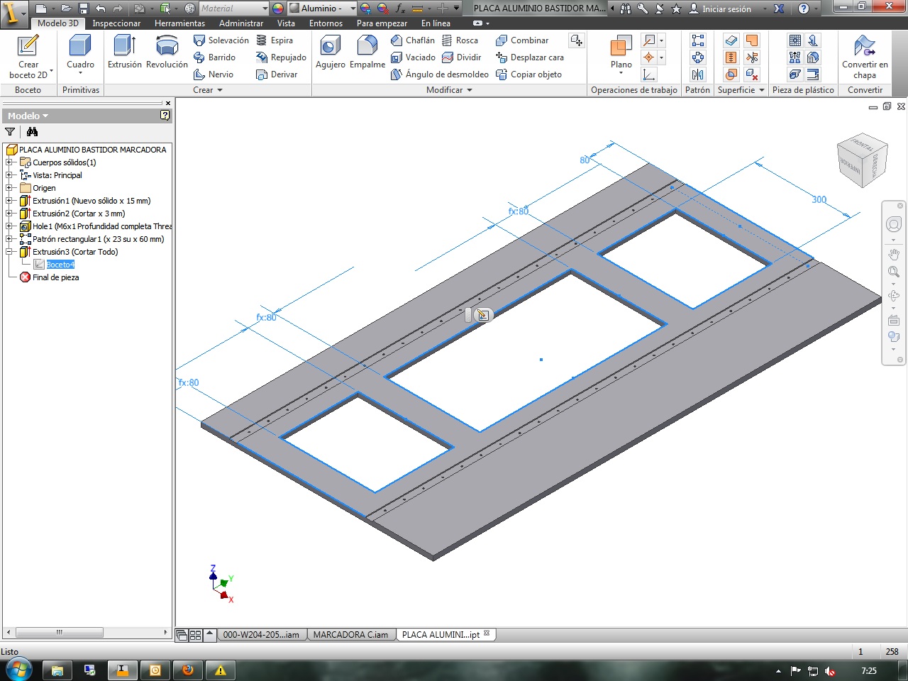

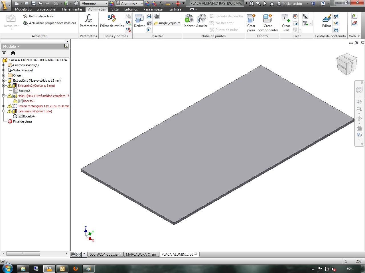

    The next example: A plate with some operations. It gives me errors on doing anything. If I try to rebuild it, all operations fail with the typical "Operation doesn't produce a significant result. Redefine inputs" (see pictures):

    Yesterday I noticed that some files in the project i'm working were huge heavy. Simple plates with a couple of holes that loads 50 MB, a pipe from a frame that loads 80MB meanwhile the rest of pipes are about 133KB, and so on.
    I didn't find the reason of this enormous load. Strangely, new parts I designed happens the same sometimes.
    I did two things: Each part with this excess of MB I applied the History compression. That repaired the size of the files.
    Then, thinking about the reason, I re-migrated the whole project to R2013 again.
    Also, I uninstalled all Windows, NET, and rest of updates. I uninstalled FireFox, Acrobat Reader, Adobe Flash, etc.
    And now my Inventor is working properly.
