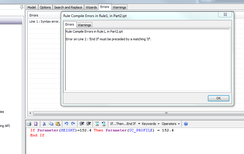

    'End if must be preceded by a matching if'
    216 Views, 9 Replies
    11-23-2012 12:41 AM
    Iv attached a picture to show the error & my rule text. I have created the Parameters etc. & the statement includes if & end if. Cheers,Capture.PNG

    If Parameter("HEIGHT")=152.4
    Parameter("UC_PROFILE")="152.4"
    EndIf
    If you are finding usnderstanding ilogic difficult, have a go at the online tutorials.

    ** Use "End IF', not "ENDIF"
    Pasting into IE erased the space.
