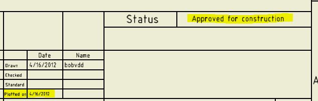

    Product Support
    Posts: 519
    Registered: ‎11-23-2005
    Re: Drawings Stamp with Date
    04-16-2012 10:41 AM in reply to: sbixler
    Let me volunteer :smileywink:
    Attached is a sample IDW (that can be used as drawing template if you like).
    Display the iLogic browser and start Form1.
    It allows you to select 3 status choices.
    The result is stored in the Status iProperty and in the drawing titleblock.
    And the plot date of course is also introduced in the titleblock.
    Here is the ilogic rule that uses a multi-choice parameter called "DrawingStamp"
    Dim odrawdoc As DrawingDocument
    odrawdoc = ThisApplication.ActiveDocument
    customPropertySet = odrawdoc.PropertySets.Item("Inventor User Defined Properties")
    Try
          prop = customPropertySet.Item("Plotdatestamp")
    Catch
          customPropertySet.Add("", "Plotdatestamp")
    End Try
    Try
    Dim PlotDate As Date
    PlotDate = Now
    iProperties.Value("Custom", "Plotdatestamp") = PlotDate
    iProperties.Value("Status", "Status") = DrawingStamp
    Catch
    End Try
    InventorVb.DocumentUpdate()
    Dim oCtrlDef As ControlDefinition
    oCtrlDef = ThisApplication.CommandManager.ControlDefinitions.Item("AppFilePrintCmd")
    oCtrlDef.Execute
    Bob

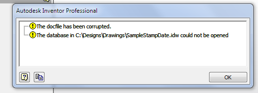

    Bob,
    Just got a chance to check out your drawing.  When I try to open it, it gives me an error... "The docfile has been corrupted"....
    04-18-2012 10:01 AM in reply to: karthur1
    The drawing that I attached originally is in 2013 format.
    Here is a 2012 version of the drawing.
    Bob
