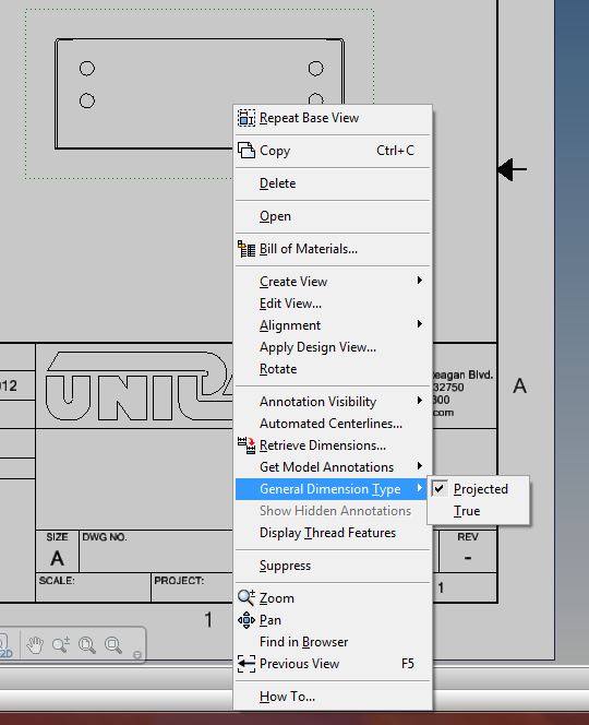

    Recently when I have placed a view of an assembly into an idw drawing, then try to dimension distances between parts it gives me strange looking dimensions, or no dimensions at all.  It looks as though the dimensions are going from the edges of each part at different angles, when I want them to be parallel to the view.  I just want the dimension from a line to a line in that view as though it is 2d, but it is acting like it is still in 3d. I do not know if their is a setting that will change this or not. But any help would be appreciated.
    I attached a screen shot of what the dimensions look like.

    Right click on view and change option in General Dimension Type Not sure what one you will need but I am sure it will be the True option..

    I just tried that and I was on projected, switched it to true and it still did the same thing.  I changed it back and forth a couple times, and nothing changed.  I am using the SMOOTH dimension style.

    Did you re-dimension it because it will not change the dimension you already placed

    yes I did.

    Alright for some reason it finally worked when I set it to projected. Thanks for the help.
