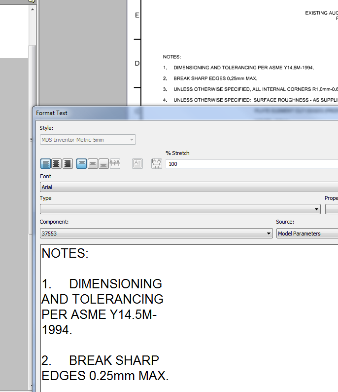

    Unfortunatly I spoke to soon in my last response. The dimension lines are still being removed by the text box. This is a terable feature. I am the one who desides what is getting blanked out on my drawing. Not some programer who has not produced a drawing in quite a number of years by the way this software has been developed.
    Resizing the text box so that it is smaller then the smallest charactor is not a good solution since it makes it very difficult to layout an sort of sturcture in a test box that is not the size you want to work with on yuor drawing.
    Attached is an example of what you are asking us to work with. Un-F_______ beleavable!

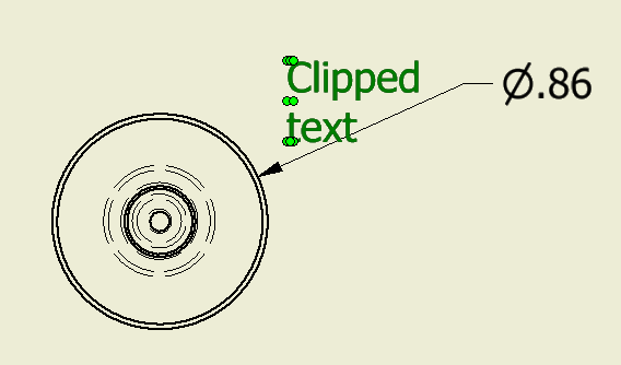

    This issue also applys to the boundaries of text boxes clipping hatching as I described here.
    While the work-around of reducing the boundary box to be narrower than 1 character works, this issue is totally unacceptable and needs be properly addressed.
    I am not sure why you would intentionally design this behavior to clip important geometry for the sake of "white space" in a text box. At a minimum I think you need to give the user the ability to control which item is "on top"- either the text box or the surrounding geometry. Another option is to give the user the ability to turn the "fill" of the text box on/off and thus control rather or not the text box clips surrounding geometry.
