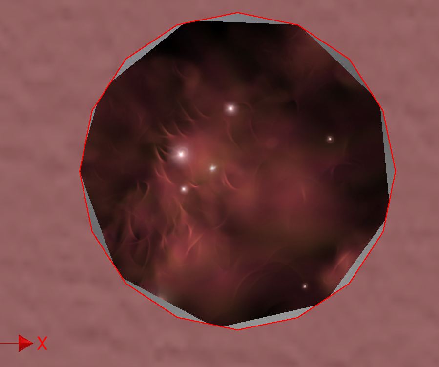

        I made a cylinder which is in the attachment. When I flat pattern produce its dxf file, I am not able to get correct geometries. When I zoom into the dxf file, I see that the inner hexagon and circles project irregular shapes and are not concentric.

    The flat patern is corect, it's your folded model that's wrong. The way you cut those, well, cuts, is not perpendicular to the face. I suggest you remodel this using a contou flange, then the unfold feature. Make all of your cuts after the unfold feature, then follow it up with a refold. This will cause the edges of the cuts to stay perpendicula to the material and allow the expected flat pattern to be created.
