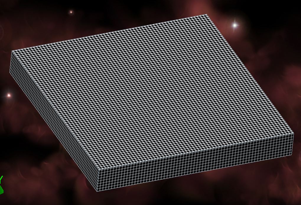

    I have a problem when I want to use a cutout.
    My purpose is to get a perforated plate but Inventor doesn't show this.
    Only the black color is shown and not the holes.
    What am I doing wrong?
    Thanks in advance
    Nick

    Re: Cutout appearance doesn't work
    09-20-2012 07:30 AM in reply to: Cadmanto
    Hi Cadmanto
    I'm not doing an extrude, but I am using the cutout option in the appearance menu.
    See the screenshot in attachment.
    Nick
    09-20-2012 07:55 AM in reply to: nick.jeuris
    I'm not sure what you did wrong, but after I cleard your overrides and set generic to use your image file it worked fine.
    09-20-2012 07:59 AM in reply to: nick.jeuris
    Sorry I misunderstood your issue.
    2 thoughts, first maybe the transparency needs to be adjusted on the png file
    and second, can you use this appearance in the color portion of the style and standard editor?
