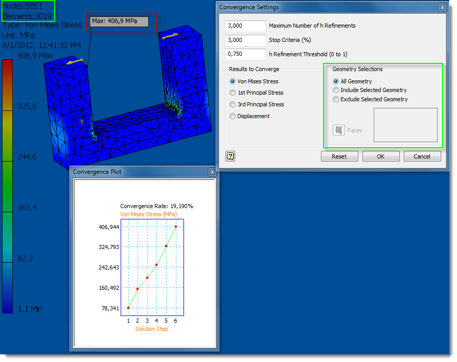

      A stress singularity is where: as the mesh size is decreased, the stress increases.  These happen at geometries like a sharp inside corner.
      Convergence: We refine the mesh at the maximum stress location, to ensure that there is not a mesh size dependence that could affect the result value.  i.e. the more dense mesh could give false indication of the 'true' stress value at that location.
      In the following simple example, it shows a model with a sharp inside corner.  Depending on the loading, it may or may not be a maximum stress location.  However, since it is a sharp inside corner without any fillet it is likely going to be a stress singularity location (geometrically and load symmetric):
    Also, keep in mind that in reality, an inside corner is most likely not a perfect sharp corner.  The cutting tool must have some kind of finite radius, which would leave some sort of small fillet, and not a perfect 90 degree corner that we can model in CAD.  So these singularities can easily be a result of the CAD model whose geometry doesn't even match with the real-world model:
    If we simulate using the default mesh, and no convergence, the maximum stress would be equal at both inside corners in 'real life'. But, when we show the maximum stress label / indicator.  It cannot point to both locations, just one.  This is why I mentioned that it is possible for the convergence to change where in the model were are refining the mesh:
    Now, let's use convergence and set h=3 and Stop criteria % = 3.  The adaptive mesh refinement will begin to refine the mesh at the high stress location, to try to converge on a stable max stress value.  However, since the max stress occurs at the sharp inside corner / singularity, the solution for the max stress value can only diverge:
    In order to overcome this inherent behavior with any FEM / FEA package, we can either add a small fillet to the sharp inside corner, or exclude that sharp inside edge and neighboring faces to be included in the mesh refinements for convergence (using the Geometry Selections highlighted in the image above in the Convergence Settings dialog).  Alternately, you can use the option "Include Selected Geometry" so that we will only consider the nominated geometry for mesh refinement in convergence.  In this simple example, perhaps you are interested in the face on the opposite side of the column from the sharp edge to converge the max stress results.
