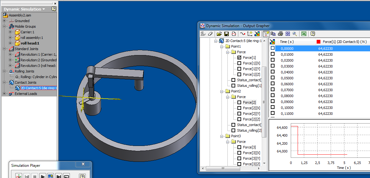

    Hi guys, i am new here on the forum, but not new with Inventor. Version i work with is 2011. I want to make Inventor calculate for me the force by which the pendulum acts towards the die ring, which is grounded. In my simulation, i defined material properties of all the parts, gravity, motion around vertical axis is set to constant value. It turns nicely. But, i can not set the die ring to be the position limiting factor to my pendulum and i can not make centrifugal force created by rotation to act on the pendulum. I attach picture of model, which i created to test if this works.  Thanks a lot if someone come up with something.

      There are a couple different ways to go about it.  The easiest way is to disable the zero deg/s^2 acceleration imposed motion in Revolution:1.  Then you can see the ~63.9 N rolling force between the cylinder and ring.
      I also re-constrained the simulation a little bit by removing the zero acceleration imposed motion in Revolution:1, disabled the rolling joint and replaced it with a 2D contact joint between the roller and outer ring.  There you can see the contact (action / reaction) force calculated as ~64 Newtons (assembly attached).
      Hope this helps!  Please let us know if you have any additional questions, comments or suggestions.

    At first when you mentioned pendulum, and had the zero acceleration imposed motion, I thought you wanted to know the reaction force at the center of rotation due to the centrifugal load of the spinning components.  I did a hand calculation and arrived at the same value as DS (158.1 N).  You can view the X or Y component of the Revolution :2 joint and see it matches exactly (images attached) :smileyhappy:
