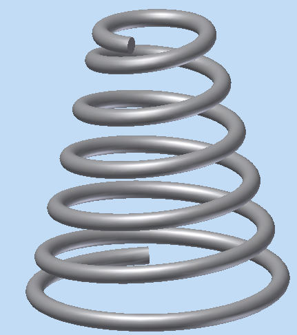

    *Expert Elite*
    Posts: 21,724
    Registered: ‎04-20-2006
    Re: CONICAL SPRING
    10-04-2011 08:51 AM in reply to: camilorivera8311
    Something like this?
    More informatioin is needed.

    camilorivera8311
    Posts: 14
    Registered: ‎10-04-2011
    Re: CONICAL SPRING
    10-04-2011 09:57 AM in reply to: JDMather
    Yes, just like that is what I need, but enabled to perform calculations on it.
    Thanks.
