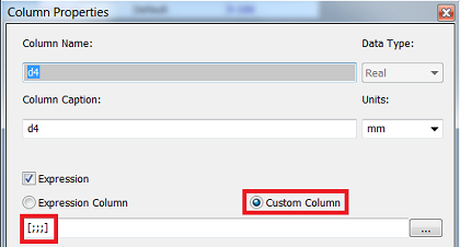

    For publishing an ipart in the Content Center in the way that you can specify the length inserting one member from the Content Center, in the ipart table you need to set the length column as Custom Parameter Column.
    If you didn’t do that, you can edit the Family table in the Content Center Editor and set the column properties as in the image below.
