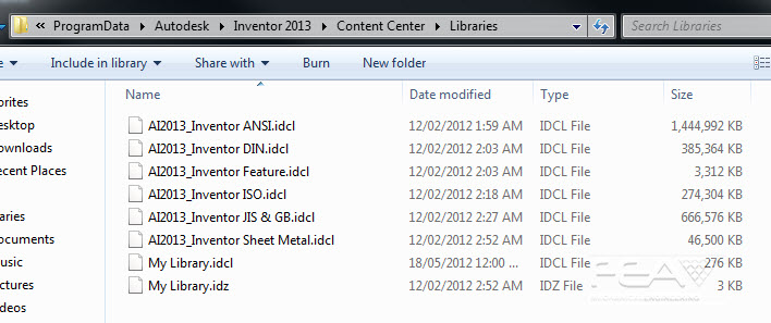

    I have the Australian Standard steel and fasteners missing from my 2013 install too.
    Again, in the filters option it is greyed out.
    I've installed/imported the standards twice now, taking nearly 1/2 hour each time but when you go to where the files are installed to in explorer, only 5 of the 11 actually appear installed. There is no OTHER content there (where the AS stuff is).
    Refreshing content, reinstalling, changing / resetting project files, has no effect.
    Though it imports the library to somewhere on the computer: its not in a place I can see.
    I even did a search for all files in the autodesk instal directory according to size: No other content even though inventors installation thinks it there.

    I've tried re-installing the OTHER content again this morning. First time the installation crashed and shut the computer down. The second time took 1/2 an hour to install (just that content only), but still, it is not available in the content centre, nor is it visable in explorer.
