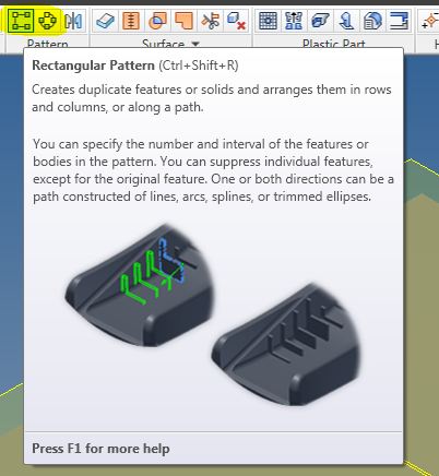

    Fefas,
    Have you looked into patterning?

    If you created the holes in the original part with a Feature Pattern you can use that same part Feature Pattern to place the LEDs in the assembly.

    Thanks Scott,
    It worked. I don't know how I haven't noticed that on the assembly I could use the patter tool.
