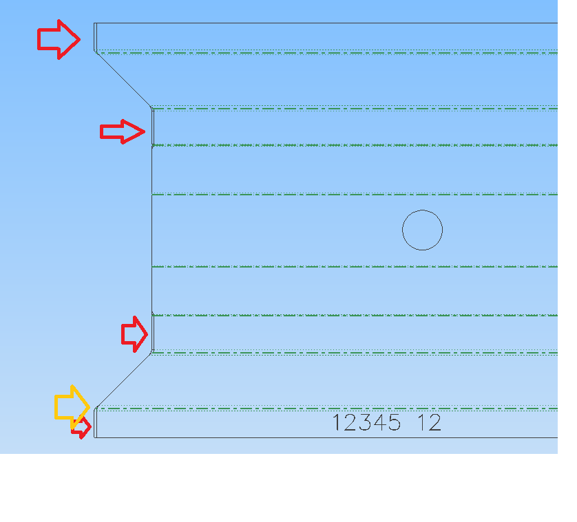

    The way you made the cut would not be correct in an CAD program as the cut edges are not perpendicular to the flat face.
    I will post an example of how it should have been done.
    If you view the flat in wireframe mode there should be only one edge (at indicated locations).
    The spline problem occurs where there is a cut across an angled bend (yellow arrow).
