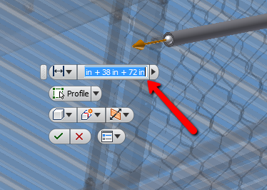

    The marking menu covers just about every thing I can do... except for one very important thing (well for me anyways).  It does not show me the value of the cell when its a function.  For example, say that I edit an extrusion whose length is (12+36+11.254-.37).  In previous Inventor versions, if I hoovered over this highlighted value, it would show me the resulting value and its name.
      Inventor 2013 does not do that.  In order to find the value I have to use the arrow keys and scroll through the box and then add it all up.  It does not even display the parameter name...like d1, d2 or whatever, like all other Inventor versions did.

    In the screen shot that you see, I was working in an assembly.  I had drilled down to the part level and I was in the edit extrusion command. I tried hoovering over it and moving off to the side (like you said). It would show the same thing if I had just the part open.
    Any of the commands that have the new heads-up display show this issue.  If I use the old dialog box in the extrusion command, it will show the sum if I hoover over it.

    This is either an oversight or a limitation in the mini-toolbar design.
    I logged it as  defect 1462266:  Mini-toolbar does not show the value of formulas
    Thanks for reporting
