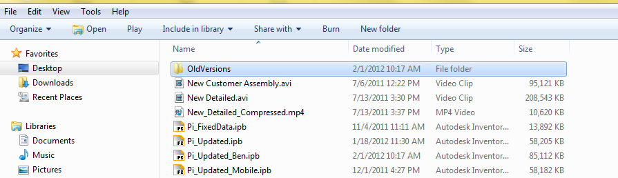

    Backup files should be saved under the "OldVersions" folder, in the same location as the original IPB file.  If they are not being saved there, please let us know.

    The Backup file will be placed directly into a folder called OldVersions, with SP2 installed are you not seeing this folder being created at all?
    It's there, but the documents are just a history of user saves, which I fail to see a use for.
    There never appears to be a crash file.
