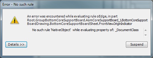

    Sometimes "getHostObject(me)" returns a document and other times a componentOccurrence.
    When "getHostObject(me)" returns componentOccurrence, no issues, everything works. In other case I have this error message. How can I resolve this issue?

    GetHostObject returns .Net reference to ComponentOccurence (or proxy to it) for the occurrences inside of assembly. For top level document (Root Part), the reference to the assembly document is returned.
    Drawing document reference is returned for the IvDrawingDocument Intent Part.
    I can guess from your refchain that you are attempting to call .Net in the context of some annotation on the drawing view. Depending on the view's Model, you may have to adjust proxy context first, and then figure out the geometry in IPT document.
    If you have the small dataset that shows your problem, you may send it to ADN.
    At least, the knowledge of the call stack will be useful at this point.

    The main goal in my case is specify entity for creating origin indicator. I want to select one part from assembly view to define all drawing curves just for this part.
    If I create subassembly separately and drawing for her, GetHostObject(object as part) returns occuranceComponent.
    If I create full assembly and drawing for the same subassembly, GetHostObject(object as part) returns document and I have error message that shown in the previous post.
    But this error is not constant.

    This is design for creating origin point on the drawing. I didn't have any problems before. May be it's not best code.
    <%%DisplayName("Origin Indicator"), %%Icon("Drawing-Annotation-OriginIndicator.ico")> _

    Rule oEdge As Any
    Dim oObject As Any
    If part1 <> NoValue Then
    oObject = GetHostObject(part1).NativeObject ' the issue is in this row.
    Else
    oObject = NoValue
    End If
    Dim iObjQty As Integer = oView.get_DrawingCurves(oObject).Count

    I have fixed my issue.
    Need to replace:
    Dim oObject As Any
    Else
    oObject = NoValue
    End If
    on
    Dim oObject As Any
    Dim oCompDef As Any = oView.ReferencedDocumentDescriptor.ReferencedDocument.ComponentDefinition
    Dim oOccur As Any = oCompDef.Occurrences
    If GetHostObject(part1).Type = Inventor.ObjectTypeEnum.kComponentOccurrenceProxyObject Then
    Else
    For i = 1 To oOccur.Count
    If part1.occurrenceName = oOccur.get_Item(i).Name Then
    oObject = oOccur.get_Item(i)
    Else
    oObject = NoValue
    End If
    Next
    End If
    Else
    oObject = NoValue
    End If
