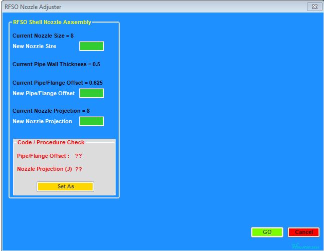

I found a couple of errors in my code but have now fixed it. However, the rule is unstable. If I start Inventor fresh, open the assembly, and run the rule, it will work most times. Occasionally it won't though, which is really weird. Also, once it has been ran you can't run it again until you close the assembly, reopen it, and run the rule. It is something inside the pipe (If IsPipe....) and/or flange (If IsFlange....) swap "If" that is causing it but I can't figure out what. I've tried resetting all variables to nil once the rule has finished but that doesn't work either. It acts like it is hung up somehow inside the "If" statement because it immediately tries to set the "Parameter(pNewRename, "PL") = OldpLength" and won't even open the dialog before erroring. Below is a picture of what the dialog currently looks like and the updated code is below that.
Any help is appreciated.

For anybody that might be following this thread, below is an image of the latest version of the dialog. It's getting really complicated but if I can get everything to work it will be awesome. We are going to convert all of our thousands of 2D AutoCad standard drawings to Inventor 3D models. With this one interface I figure we can eliminate somewhere around 5-6000 2D drawings with one dialog, one internal rule, one external rule (Mike's Content Center Replacer), one assembly, three part files, and one drawing file. That's pretty awesome!! See latest dialog below :
I do have a question though. In some cases, with smaller nozzles, the repad is not required and it needs to be suppressed. The code snippet in iLogic rules for "IsActive" (true or false) doesn't seem to want to work. I can turn the repad visibility on and off but it needs to be suppressed so that it doesn't show up in the drawing and bill of material.
Any ideas?
