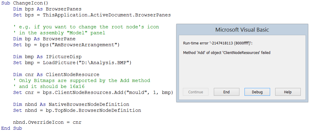

Gives Add Method Error. See Attachment

I believe this code is unlikely to succeed on 64-bit because VBA is running out of process. You would need either to use 32-bit VBA or try the same from a VB.Net/C# add-in. The way to load resources if different however in .Net.
You can refer to the following articles:
hhttp://adndevblog.typepad.com/manufacturing/2012/06/how-to-convert-iconbitmap-to-ipicturedisp-witho...
http://adndevblog.typepad.com/manufacturing/2012/08/change-the-browser-node-icon.html

MjDeck
Attached is an iLogic rule that will work for an assembly or part document.
