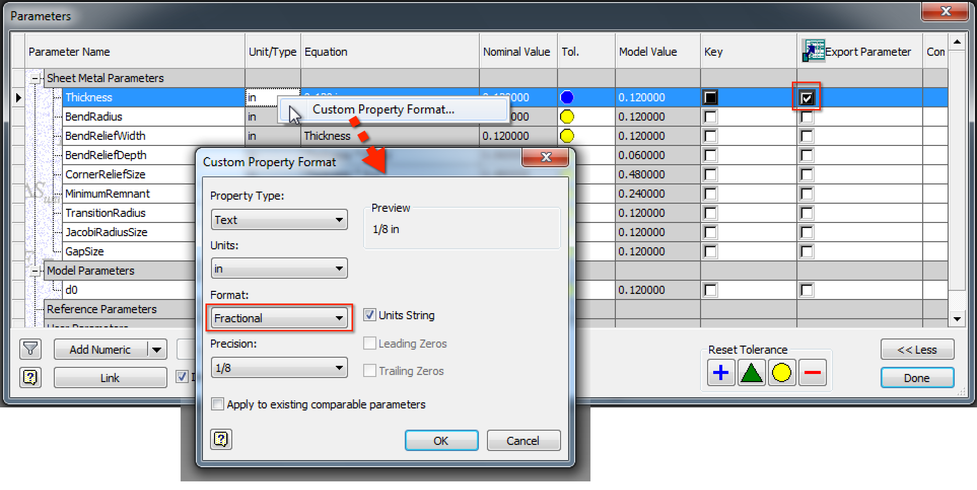

Hi Sean,
If you open up the sheet metal part and then go to Manage >> Parameters, then you can tick the Export Parameter column for Sheet Metal Parameters >> Thickness. This way "Thickness" will be available from the sheet metal part document under "Custom Properties - Model" when editing the title block.
You can also change the unit so that the thickness will be shown in fractional format.
See below pictures.
I hope this helps.
