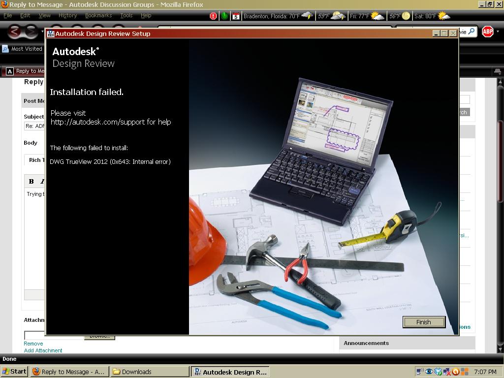

Trying to install ADF2012 and get the following error every time:
It says :the Following Failed to Install: DWG Trueeview2012 (ox643: internal erroe)

Message 8 of 156
in reply to: Anonymous
Rest of the Story:
IBM T23 laptop, Windows XP
Message 9 of 156

Your case shows ADR 2012 installed as normal but DWG Trueview 2012 install failed.
There is a new change for ADR 2012 installer:
It will check DWG Trueview 2012 installer as a bundle installation by default, which is not in previous release.
So we would like to know if you're really going to install DWG Trueview 2012?
-If not, you can uncheck the option "Also install DWG TrueView to open DWG files directly from within Design Review. " before install ADR 2012 bundle, and then continue to install ADR 2012.
-If yes, we suggest you uninstall any exist DWG Trueview application and try it again, or just install the application from:
http://usa.autodesk.com/adsk/servlet/pc/index?siteID=123112&id=6703438&DCMP=ILC-DWG-PUV
Hope it will help you resolve the problem.
