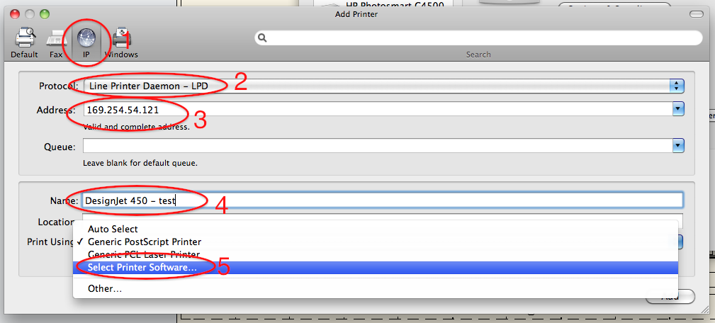

I've been doing it this way:
1. Add printer with "fake" IP address(3) - something to work around system limitations of the MAC OS when installing printer.
You can name your printer as you want (4).

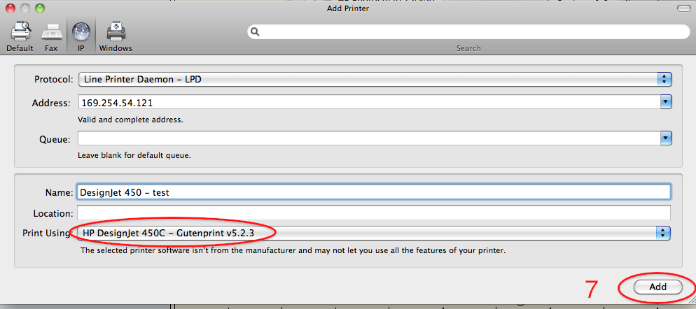

2. Select driver for your printer:
It should be "HP DesignJet 450C - Guteprint"
3. Click Add in Add Printer dialog
Now, try to repeat your steps in printing from AutoCAD and use name of the printer, that you just install (4 on first screenshot).
HTH
Maxim
Thanks for the detailed response/instructions. Added printer exactly as you described...still prints with same poor results. I noticed your printer driver for the DesignJet450 was v5.2.3, mine was v5.1.3 (as all of my Gutenprint drivers are). I am using Mac OS X 10.5.8, not Snow Leopard, for what it's worth.
