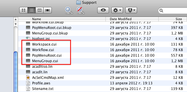

    2. Inside this Support folder locate four files with .CUI extension:
    and copy them to the same folder on another Mac (you can backup existing files before overwriting them).
    3. If you used custom icons for Tool Sets palette, then you have to copy them too (put them somewhere on Support files search path)
    4. Start AutoCAD LT on another Mac and verify results.
