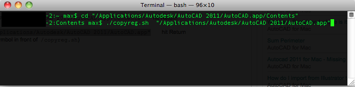

maxim_k
in reply to: yaronauto
cd stands for Unix command "Change directory",
you have to open Terminal.app (in Utilities) and type exactly (with quotes):
first line
cd "/Applications/Autodesk/AutoCAD 2011/AutoCAD.app/Contents"      hit Return
second line
./copyreg.sh  "/Applications/Autodesk/AutoCAD 2011/AutoCAD.app"      hit Return
(don't miss point - first symbol in front of  /copyreg.sh)
