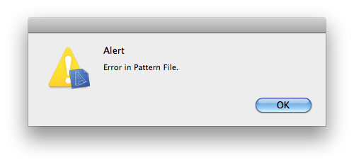

Actually it must be something else as it comes up with a couple of error messages everytime I go into a hatch command in any drawing.
Either way it is very annoying, especially as I have reverted back to the original acad.pat file.
Message 10 of 21
maxim_k
Hi John,
It appears that you have some ".pat" (with single hatch definition in it) somewhere on AutoCAD Support File Search Path, and this file have an error. An error message should look like this one:
Check, please, AutoCAD Support File Search Path for additional .PAT files.
Maxim

Hello I am Having this problem please help me.
Message 12 of 21
maxim_k
Welcome to the Autodesk Forums!
At what moment exactly do you get this alert - please provide more details.
Maxim
Maxim Kanaev
Architect
MARSS
MacACAD | Linkedin
Message 13 of 21
Well I get this message when i Decide to hatch  something I open the hatch tool and when I click Hatch it appears this message is pretty annoying please help me.
Message 14 of 21
maxim_k
Not absolutely sure, but maybe you have this file 3tab.pat somewhere on AutoCAD support files search path (or maybe in the same folder as the opened DWG file). It seems this file have errors in hatch pattern defenition and AutoCAD can not load it correctly to Hatch library.
Try to find this file - 3tab.pat - on your Mac with Spotlight search and move it to some location where AutoCAD will not find it (external flash drive for example). then try to use Hatch command.
Maxim
